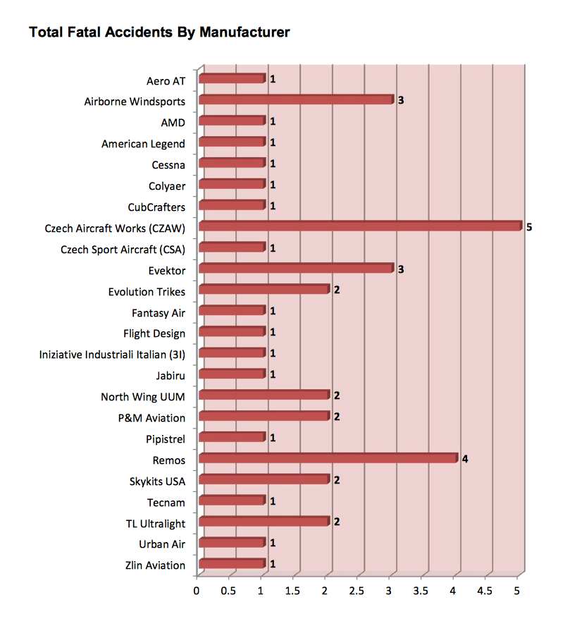

I'm interested in your guys thoughts regarding the 10 year FAA SLSA safety report. Specifically two charts on the report. They demonstrate number of fatalities in each model of SLSA, and the percentage of fatalities as a total fleet. I thought it was eye opening, and made me wonder about some of the specific model's higher tendencies to be in a fatal accident. I know the vast majority of accidents are due to pilot error, but are there planes that are safer than others all things being equal? With a smaller sample size, is it just a statistical blip? Perhaps some planes are more difficult to fly and less forgiving? I've attached both files from the report.

Given the total number of accidents in 10 years, the numbers actually look pretty good.
One fatal vs. five fatals is still a very small number, especially if pilot error factors in.
Flight design is amazingly low, given the number of aircraft produced... as is Tecnam.
On the other hand, there are some brands that are possibly higher risk (airframe or motor) that still do well in the stats.
** I would search the NTSB for specific causes of accidents for any make & model that you are interested in.
Knowing WHY there was a fatal will provide greater insight. **
(As will researching non-fatal incidents & accidents.)
For example, before buying my aircraft I researched Czech Aircraft Works / SportCruser / PiperSport:
Only two fatals come to mind...
1) Canopy unlatch in flight, likely related to the pilot unbuckling his seat belt and reaching for luggage during a night flight.
(the canopy is something specific to this make and model to be cautious of, with contributing pilot factors... but not a deal breaker IMHO)
2) More recent fatal... suspected that the pilot took off with the fuel selector in the "OFF" position...
(same fuel selector as many other brands... clearly pilot error.)
You will find similar case studies with all brands...
If a mechanic left tools in the fuselage that jammed the flight controls... obviously that should not be reflective of the safety record of the aircraft.
It it was a training accident doing aggressive maneuvers at low altitude... then clearly there are contributing factors which are not necessarily the fault of the aircraft.

One thing that's interesting is if you look at the original manufacturer of the Sportcruiser, the fatality rate in that plane is 5.8% of total sold, arguably very high. But the same plane built by the new company that took over after CZAW went out of business is .8%, or over an 85% drop in fatalities. That would lead one to believe something changed in the manufacture of the plane. A design change? Different parts?

The only trend I can see appears to be low wing versus high wing. As a whole, low wing fatality rates appear to be significantly higher.
Flight Design, Cessna, Cubcrafters, Tecnam lower rate
Evektor, Original Sportcruiser, higher rate

Some planes on that list have a fatality rate greater than others by a factor of 10. I consider that statistically significant.SportPilot wrote:Personally, I don't think there is enough data to be statistically significant. I would decide what airplane I wanted to purchase based on all other considerations, then study the accident information for that airplane and decide if it had issues. For instance, the Remos has foldable wings and tail. There have been some accidents where the elevator control came lose. I would explore that if I was thinking about buying a Remos. I'm just using that as an example. I'm flying a Remos Saturday.

Significant by statistical standards or not, it would sure be significant to me if I were buying...

When you see 5.8% of the original CZAW planes end in fatality in ten years, with over 100 in the skies, that's statistically significant. The CTLS has .3% with almost 400 flying. That's statistically significant.SportPilot wrote:It's not statistically significant. There is not enough data. Read the accident reports and see if you can detect something about the airplane that would make you feel it is not safe.Cluemeister wrote:Some planes on that list have a fatality rate greater than others by a factor of 10. I consider that statistically significant.SportPilot wrote:Personally, I don't think there is enough data to be statistically significant. I would decide what airplane I wanted to purchase based on all other considerations, then study the accident information for that airplane and decide if it had issues. For instance, the Remos has foldable wings and tail. There have been some accidents where the elevator control came lose. I would explore that if I was thinking about buying a Remos. I'm just using that as an example. I'm flying a Remos Saturday.
Almost 20 times the fatality rate for a certain make of aircraft. Just because you don't want it to be significant doesn't make it so.
