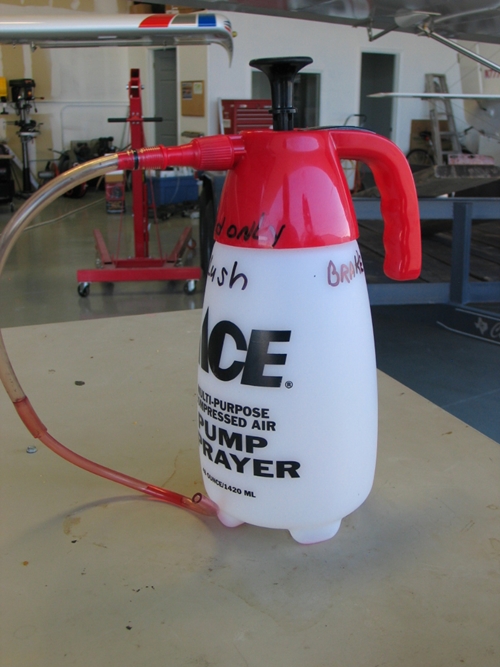

Whose brakes are they. There are different ways to bleed some brakes. The most common for most brake systems is from the bottom up. There are a couple of brake systems out there that take a special procedure and there is no written documentation to do it. The Gobosh is one of them.
Most systems should be bled from the nipple on the bottom of the caliper. The fluid is then pressurized up through the system into the reservoir.
The best and cheapest tool to do this can be had from Ace hardware. It is a 1 gal. pump up bug sprayer. Take off the front nozzle and just slide on some tubing. Pour the fluid in the pump, pump it up and attach the tube to the bottom of the caliper nipple. Then open the nipple on the caliper a couple of turns, press the trigger on the pump and the high speed fluid flow will flush out all air and charge the syste, Put an empty water bottle with a tube on it up on the reservior to catch the over flow. I usually waste maybe 1 ounce. The high speed flush carries air out. Using a slow hand operated oil can is too slow and many times leaves air in the system. The Ace pump is a bout $10 and well worth the money. I can bleed brakes in a few minutes this way. Give me an email address and I can send you a couple of pictures.

That's pretty much what we've tried Roger, but using a "hand operated pump can". Perhaps we didn't get the brake fluid pushing through fast enough? I'll have to pick up a bug sprayer this morning.roger lee wrote:Whose brakes are they. There are different ways to bleed some brakes. The most common for most brake systems is from the bottom up. There are a couple of brake systems out there that take a special procedure and there is no written documentation to do it. The Gobosh is one of them.
let me know whose brakes they are and I may be able to help.

I'm sitting at a yard sale right now. I'll try and post some pictures a little later. If you have any questions call me. The little hand pumps don't do very well for getting air out. To slow and the fluid just goes around the air instead of forcing flushing it out.

Brake flush pump. Best thing ever and easy to use and works like a charm for about $10
- Brake Flush 002.jpg (212.1 KiB) Viewed 23212 times

I don't think you'll find a suction style bleeder to work as well as a pressure bleeder.
First you'll have to keep an eye on the reservoir and air wants to go to the high points so as the fluid is sucked downward air still wants to travel upward. The slower suction type bleeder won't move the fluid fast enough to make the procedure efficient or quick. The suction type bleeder is for more specific applications. I think you may find it more difficult. I have tried them and they are frustrating to get a good job in any decent time frame. Our brake systems were meant to be flushed from the bottom up. You'll also need more equipment. All I need is the pump and a empty water bottle and it doesn't leave a mess.
Here is a test. I can bleed both calipers on a plane with my pump in about 15 min. total and never have any air bubbles. I only waste about 1 oz. of fluid and the reservoir is always full and you'll never have to watch it to make sure you don't have a low level.

So we tried Roger's methodology yesterday ... semi-successful.
After about 20 minutes of pumping fluid up from the brake caliper, we took out the seat to trace the brake line.
Under the Pilots seats, we found a "hump" in the brake line, that routed the line up & over the wing spar ... that "hump" was full of tiny bubbles.
We temporarily re-routed the line and were able to get out "most" of the bubbles ... we still have some, we can't get to move through the system.
We even tried to bore out an old fitting to use on the caliper, so we could generate more pressure, but weren't successful with that.
So as of yesterday (haven't checked today), I have reasonable brakes, with some tiny bubbles in the lines.
