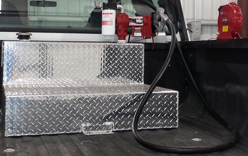

I put a reel ( bond cable ) and a coil ( ground cable ) on my fuel trailer so I can bond it to my plane as well as ground it all to the hangar's ground.
The equipment was expensive and bonding alone without grounding would have been the same level of protection that you get from the fuel truck but I have both now.

Re: How do you handle filling your LSA with auto-gas?
- CT Xfer Tank.jpg (121.56 KiB) Viewed 10032 times

If liked the transfer tank, pump and grounding set up in the pickup. For those without a pickup, here's another option (a bit spendy, though).
