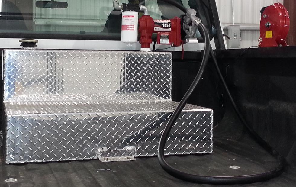

You can use gas cans. You can also get a transfer tank and pump, put it in your PU truck. There are also gas caddys that have a hand pump and hose.
You check water and dirt the usual way as with 100LL, at the gascolator. Always check your fuel after fueling, wait about 20 mins for that...
91E10 or 91 non ethanol is okay to use in Rotax engines. If using fuel with ethanol the larger consideration is the aircraft fuel tanks and hoses in the fuel system - are they compatible with corrosive aspects of ethanol. In the Flight Design CT the answer is yes.
