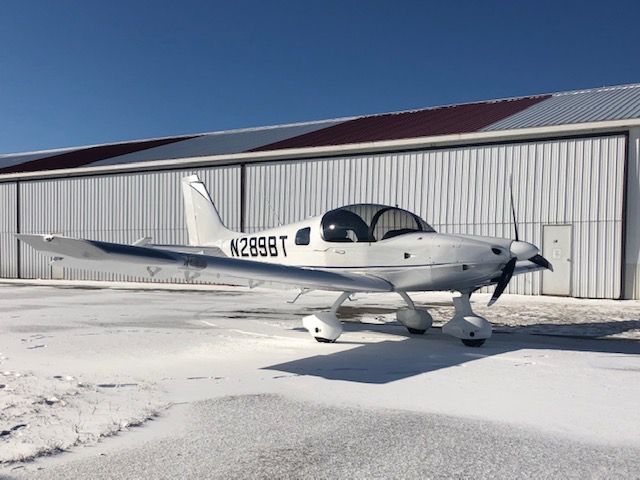

A little pattern work and presto!
- IMG_6005.jpg (71.51 KiB) Viewed 15545 times
Congratulations, cam. You look way too happy in that bottom photo, but that's clearly understandable given all the sweat equity you have in your magnificent machine.

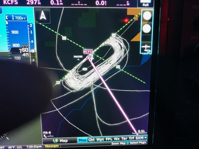

ANOTHER great day at Midwest Sky Sports! Windy, gusty, rain, snow, marginal VFR, cold as crap, etc... SO, let's go fly! 3 flights and 3 more hours bringing the aircraft time to 28 hours of the 40 needed for FAA required fly off within 25 nm of KCFS. BTW, that is not a problem...many airports within 25, beautiful farm country with lovely windmills (sarcasm on windmills)...not to mention Lake Huron coast.
(IMPORTANT SAFETY NOTE: I am a 17,000 hour pilot (not Chuck Yeager), current airline pilot, former usaf f15 pilot, former 200 hour 152/172 pilot, blah, blah, blah...I say that because I don't want to encourage a 60 hour pilot to fly a 100 hp airplane in 42 knot winds/low ceilings/x-wind, etc)
Anyway, 3 flights today at KCFS. High winds, low ceilings...lowest about 1200 broken...highly variable ceiling...I just stayed 500 below the bottoms in the pattern. My first flight was 1.4 hours and it was continuous light turbulence, and lots of occasional moderate turbulence. Bottom line? The Sling 2 handled it NO PROBLEM. Sure it was bumpy, but when you get down to the flare you feel the amazing ground effect, things (like the x-wind) calm down and it works out great for a good landing every time...HOWEVER, I had to really learn to use those silly rudder pedals again. On final, I say to myself "OK, Happy Feet ", tap the pedals to get warmed up, and remember the stick is the liner-up-on-the-centerline-thingy, and the pedals are the point-it-straight-down-the-runway-at-touchdown-thingys. And do not forget, with a steerable nose wheel, you do not want the nose wheel touching down first (..ummm..ANY TIME) or at the' same-time-as-the-mains' at the initial touchdown in a crosswind...because your crosswind rudder input is replicated in the nose wheel... So, you might make the perfect crosswind corrected landing, but, with an insufficient flare or somehow getting the nose wheel on the ground simultaneously with the mains, you will kind of veer opposite of the crosswind direction...If you do...no biggie...Sling is tough. Anyway, my point is that THIS AIRPLANE IS COMPLETELY AWESOME...EVEN IN LOUSY NASTY BUMPY WEATHER. It is really so easy to fly and SO SAFE. It is a real stick and rudder airplane. JUST SUPERB.

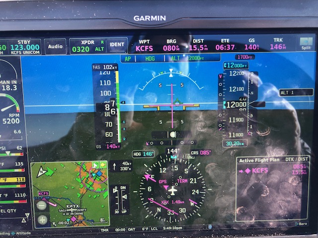

32.0 hours now. Should finish the fly off tomorrow or Monday. Great day of snowy runways, high x-winds, max performance climb to 12,000, RNAV approaches, ...just an amazing bird.
