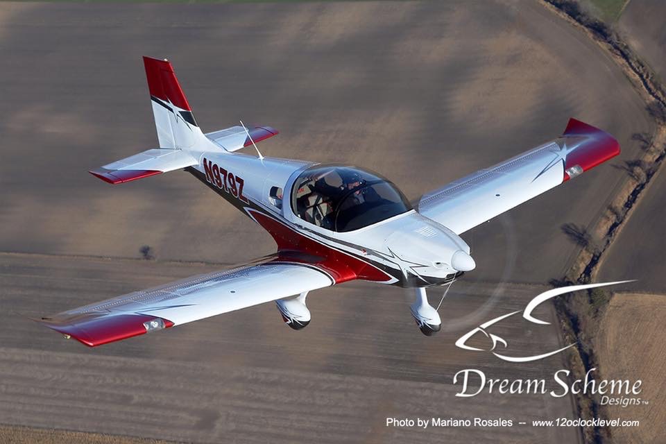

This?WDD wrote:Hopefully they will make the iS less heavy as well. If for example the new iS rv12 has greater fuel effeciancy but you have to carry less fuel because useful load is less - doesn’t make sense.
To the OP - congrats on making the choice. Now on to the most difficult decision - what paint / design ?

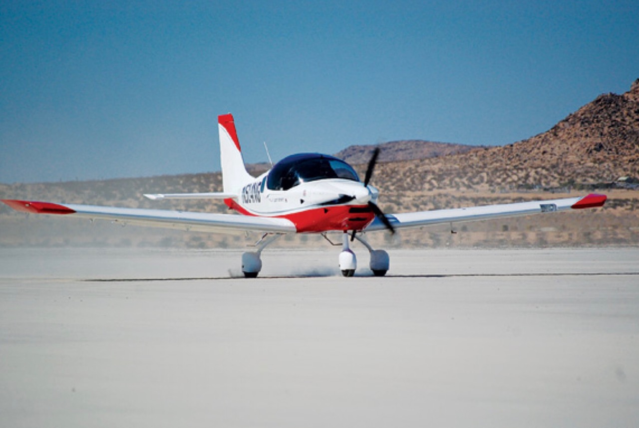

Basic...Red Belly Warbird...
- IMG_0005.jpg (141.67 KiB) Viewed 9370 times
Re: Rotax 912iS or 912ULS for Sling 2 ???
That used to be my favorite color scheme ( the orange version ) until I saw this sling 2..
No, this one is better.
