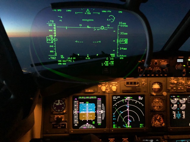

OK, it is not technically my panel. It is Herb Kelleher's panel. (I love that man.)
What is amazing to me...is, I learned to fly, in the 1980's, Cessna 152's, 172's, 150's...I love those airplanes. However, I recall being lost one night over south central Kansas/North Oklahoma...etc... That is virtually impossible today...GPS/iPads/iPhones/Garmin xxx? etc...

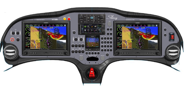

What is more amazing to me...is, for what I consider "reasonable" prices...I can get the same technology I have in the 737-800 I flew tonight...actually a bit better...ie: Garmin G3X Touch has synthetic vision...I do not have that in SWA 737...my Sling will do better RNAV approaches than the 737...our 737s have no WAAS capability yet...the Sling does...LPV approaches to 200'!...our 737 RNAV(GPS) approach mins are usually a couple hundred feet higher than LPV mins...oh, if I go missed approach in the Sling by hitting the TOGA button, the Garmin auto-pilot will fly the missed approach and holding pattern while I monitor...SWA 737 auto-pilot kicks off if we hit TOGA, so we hand fly the missed/go-around...(SWA is really 'cheap')...also, the Sling will make traffic callouts...ADS-B In/Out will supply traffic and weather at no charge...in seconds I can plan my flight in ForeFlight, transmit it wirelessly to the Sling which loads it into the GTN (or G3X Touch if no GTN), and off I go...
So.......I really like the Sling and the Sling panel....courtesy of Midwest Sky Sports...(they are the best).

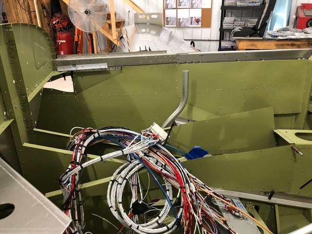

I am back to work on the Sling 2 in Caro, Michigan. Another plug for Midwest Sky Sports...they are really THE BEST. I cannot say enough good about the entire team here. (If you are jumping in late...I am doing a 51% EAB Sling 2, at Midwest Sky Sports...allows me to fly 1540 gross weight (legally), equip and fly IFR, etc...)

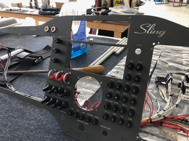

Wings are now attached, winglets installed, flaps and ailerons complete, panel waiting on Garmin glass, center console looking good, Rotax 912 ULS should arrive in a couple of days. We are hoping to fly by the end of September. Maybe even fly it home to Florida by end of September. This is so much fun.
more pics...
Another great day of riveting...LOTS of rivets! Lots of work on the luggage compartment and flight controls today.
