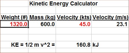

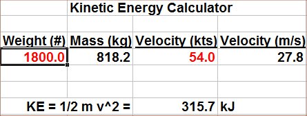

Not only did they raise the max gross weight for the Terrafugia Transition, FAA also relaxed the stall speed restriction. The result is a doubling of the kinetic energy that must be dissipated in a takeoff or landing accident.
Here are the numbers for an aircraft that complies with the LSA rule:
And here they are for the Terrafugia Transition:
Doubling the KE means that the fatality rate in the event of an accident is also essentially doubled.
Unless the plane is structurally more sound to withstand the additional KE.
But that is *exactly* the argument rejected by the FAA when weights limits above 1320lb were discussed! EAA and others argued higher weight allowed more crash-resistant structure, and the FAA roundly rejected that argument because of the kinetic energy math, as Paul posted.
