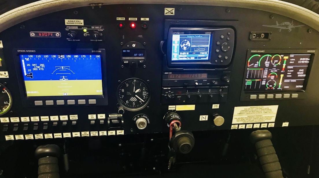

Thanks Paul. Lots of good information there. My Sportstar is more oldschool. It doesn't have the Skyview system. Here is a picture of my panel.
Instr Panel smaller.JPG (108.34 KiB) Viewed 12020 times
Re: ADS-B for Evektor Sportstar?
That looks very much like the panel of my first SportStar, Dave. Its S/N is 2006-0810. What's yours?
