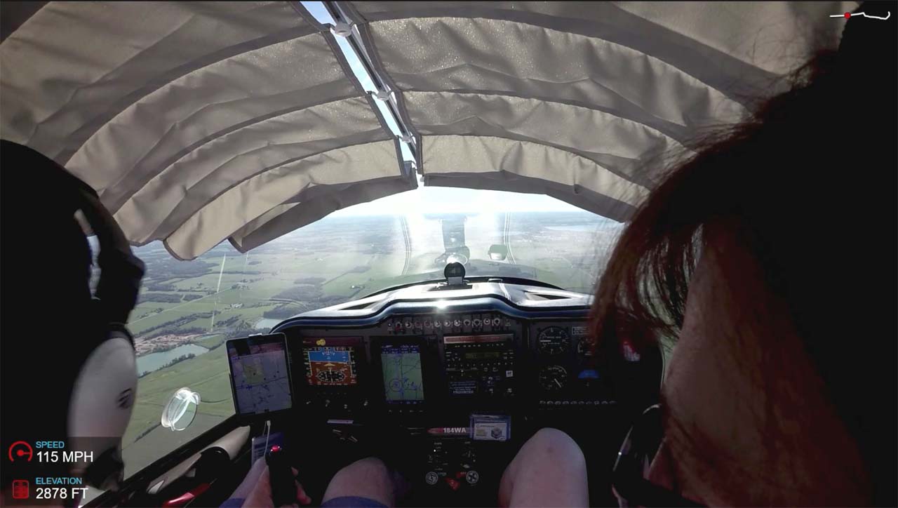

My plane came equipped with the shade and I use it quite a bit.
It is not the same as AC of course, but the only time we ever get hot is on the ground only - the shade works just fine in the summer ( to block the direct sun heat ) and in the winter ( as a pure sunlight shade )
