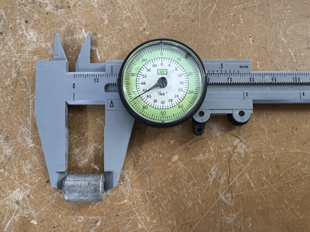

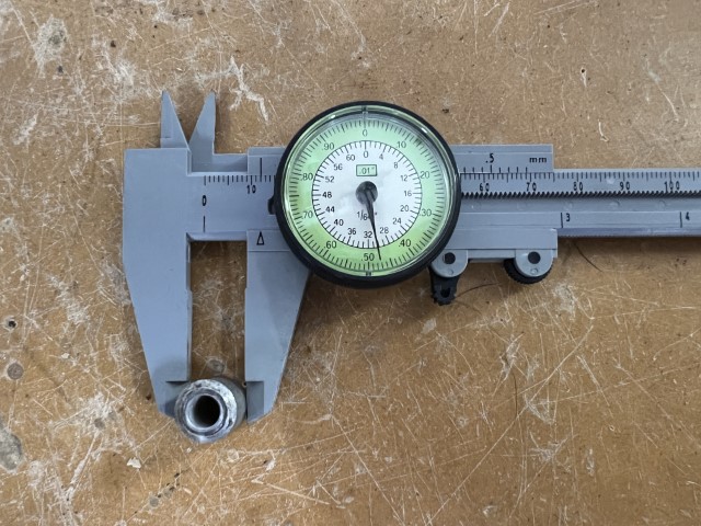

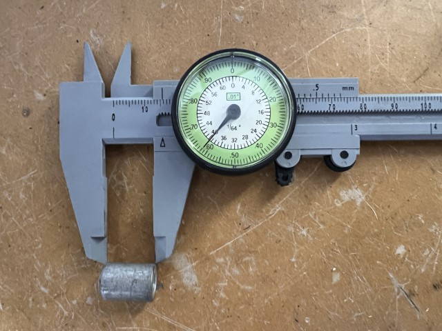

Stingsport Wheel Pant Spacer
Fellow Sting owners, I'm looking for pics, dimensions and information for the MLG wheel pant spacer, AMM Fig 7.24.
I'm pretty sure the one I have is not correct and whatever I had on the other side has departed the aircraft.
Thanks
Thanks

Hoping these pics help. I'm no machinist and there is a shoulder machined into one end of the barrel so I attempted to take two pics to show about how much of the barrel is machined.

The pics are great.
I'll get them to my machinist and see what we can come up with.
Thank you!

JJay, thanks again for the pics.
I had a friend make me a couple spacers from Derlin 3/4" round stock.
Perfectly drilled for the 8mm bolts, no slop like my previously installed spacers.
They work great. I installed all fasteners with blue Loktite as recommended in the AMM.
Looks like the previous installer did not.

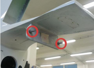

Hi Fellow Sting Owners.
I have a 2002 Sting Carbon and are due to check the elevator stabilizer - Service Notification 043012
Inspection of horizontal stabilizer connections.
Can anyone advise good advise on this procedure and the approx time it took to carry out.
Thank you
Thank you
